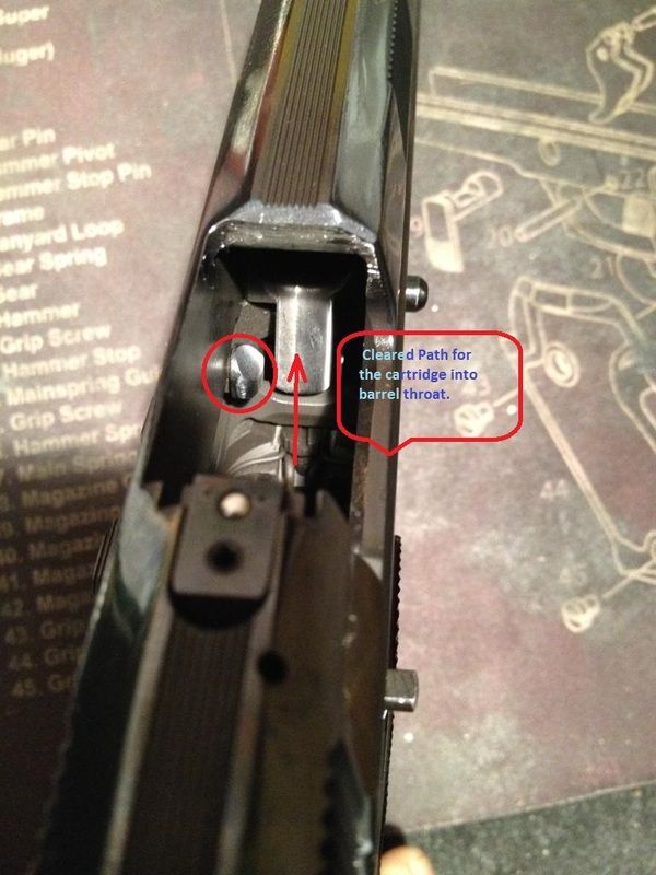

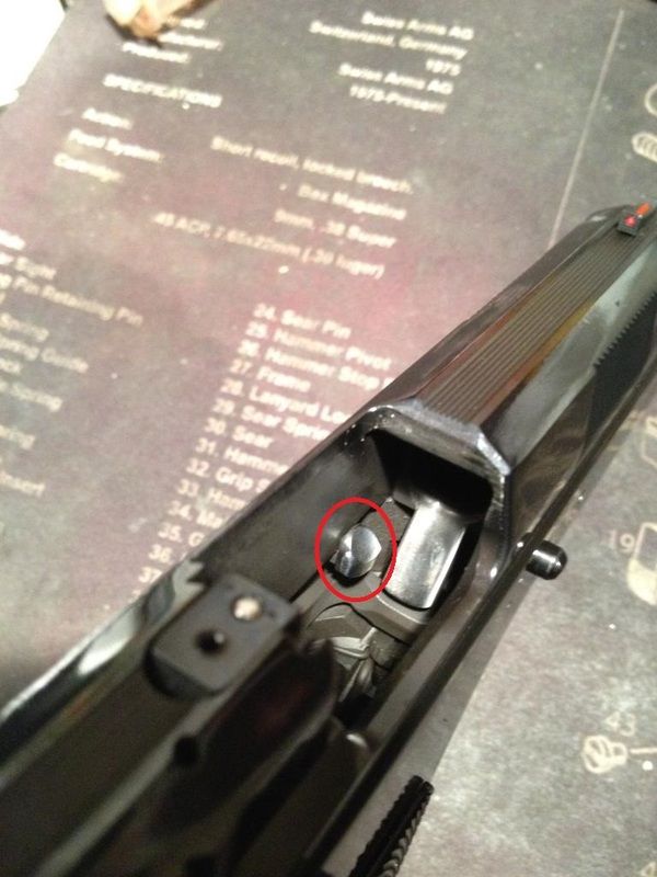

            I had FTF with my glossy blue 97B on the first range trip. It turns out the point of the slide stop extended right in the pathway of the feed ramp deflecting the cartridge from inserting into the barrel's throat correctly. What I did was replicate the shape of my SP-01 Shadow Target's CZ Custom reprofiled slide stop. After that was done all the FTF issues disappeared and has feed flawlessly since then. After that mod it will also feed heavier or longer OAL bullets. With your gun empty, open the action and observe if the pointed slide stop is in the way of the cartridge path. You can insert a magazine with a snap cap and slowly close the action to observe it in fact does deflect the cartridge from feeding straight. I would also polish the feed ramp and throat of the barrel.
