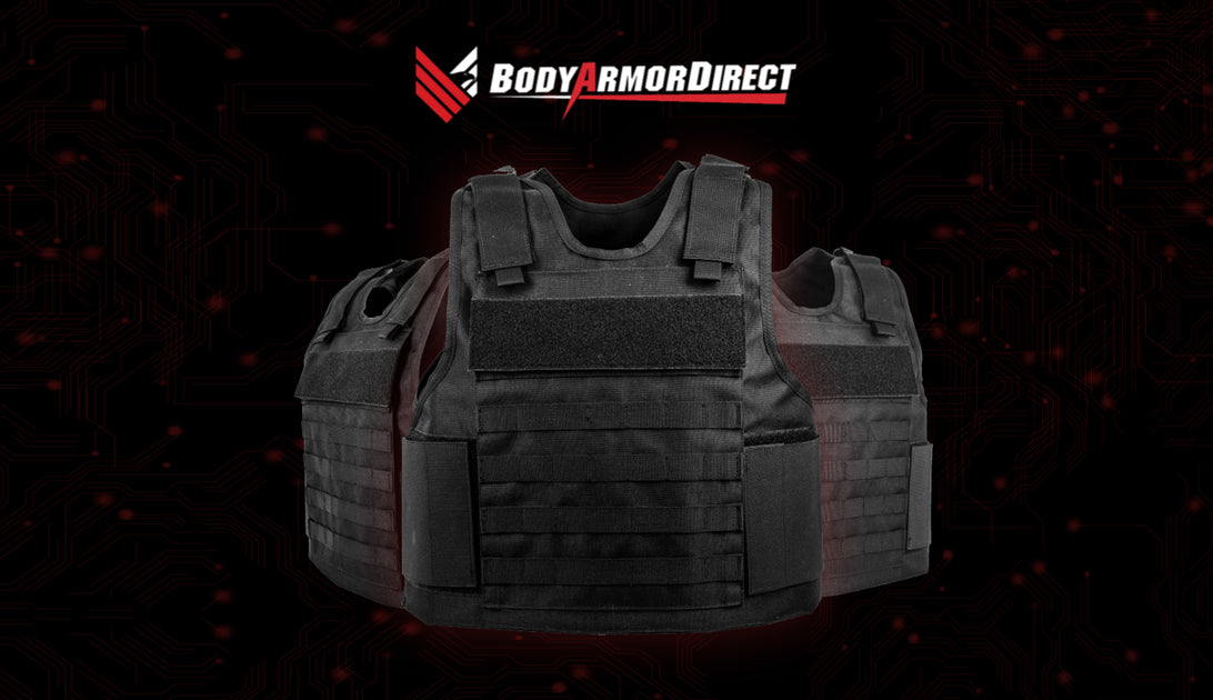

    Bulletproof vests can only last for a certain amount of time. After that time has elapsed, the protection that is offered by the vest may begin to diminish. You need to consider all of the factors that can affect the life of a bulletproof vest so you know when the time is right to replace your body armor.
