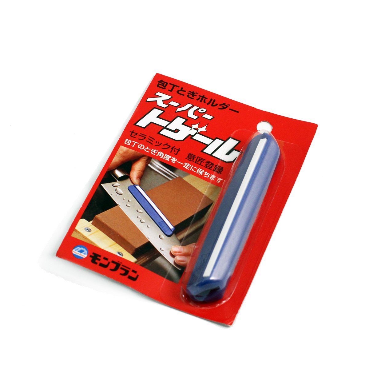

            what do you guys think of something like this?
            I suppose you'd have to get the right one for each knife though, depending on the edge angles.
                        http://www.amazon.com/Super-Togeru-K...ng+angle+guide
                        包丁とぎホルダー "bouchou toki horuda" = knife sharpening holder
                        スパートゲル "super togeru" = super accomplish
                        セラミック付 "ceramic tsuki" = ceramic attachment
                        Wow, calguns japanese lesson!
                        Angle guides never seem to be at the exact angle that I want...
                        Also, as the width (breadth) of the blade changes moving toward the tip, the angle of the guide needs to change. Otherwise you end up with a wider angle at the tip than at the the back of the edge.
                        Slow and steady practice makes them unneeded.
