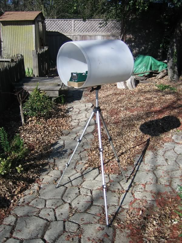

                            I've used a Chroney never worried about sky screens. I don't chrono much these days
                              Is that an outhouse in the background?

                                never used it for that.its gone now
                                we jus do it in the woods
