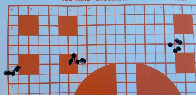

              I was testing loads this morning for groups and velocity. I don't want to mess up my aiming point by putting a bullet hole next to it.
              In the first group I held on the lower left corner of the orange square and it was to close to my point of aim. The second group I adjusted up two clicks and held for the bottom right corner of the next orange square. It was also to close to my point of aim so I adjusted it up a couple more clicks.
              I hold on the 90 degree angle of the squares to give me an exact aiming point, I don't want to mess that up with a bullet hole.

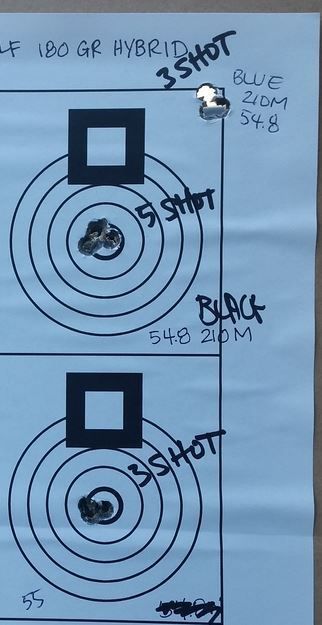

                    I prefer being precise and accurate
                    Inside center bull (white space) is 0.356"
