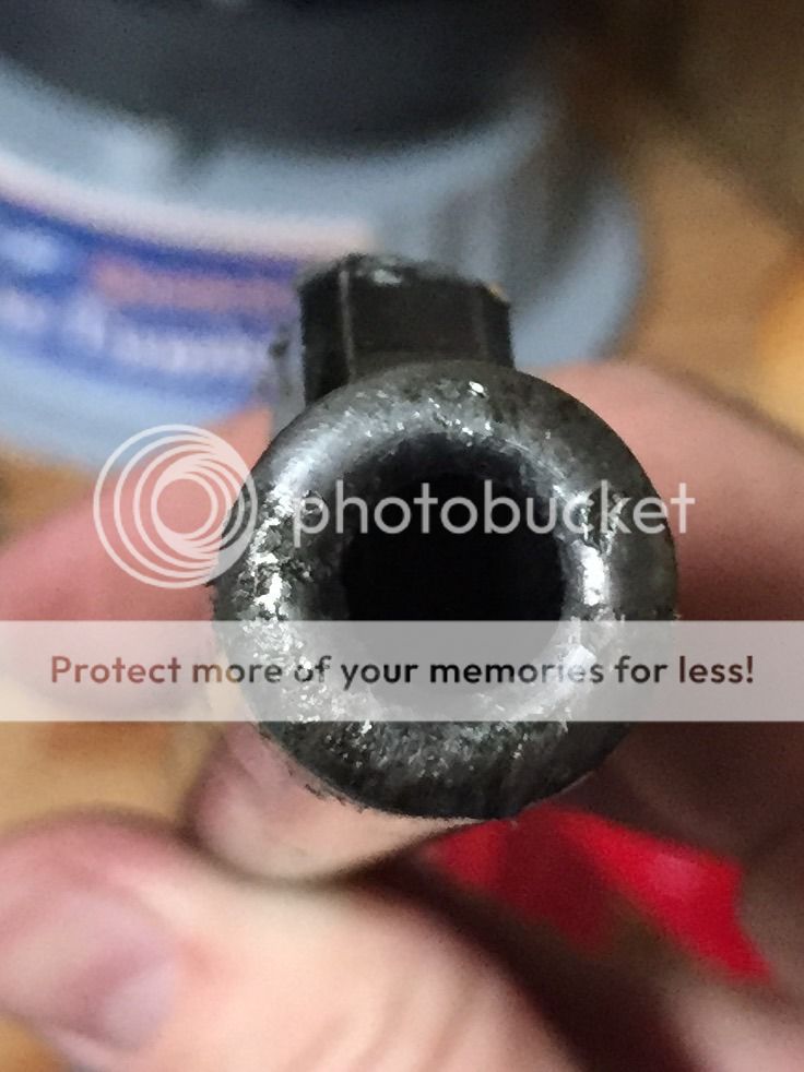

    A rifle fell out of a truck on a country road and the stock broke and there is asphalt stuck in the muzzle of the barrel. Any suggestions and what are the chances she's gonna be ok?

    What kind of rifle? Picture of damage? Give us something to work with.

      Well with a broken stock definitely not ok to shoot unless you want to hold it like a pistol.
      Everything else requires a picture to see.

        Well the stock can be fixed or replaced depending on the model and money put into it
        The asphalt can be pushed out with a rod. The rifle crown should then be cleaned and possibly re-crowned depending on if there was any damage.

            Oh it is a remington 742 30-06 semi auto. Bolt seems in working order and the stock retaining screw bent. I will post pics as soon as I can figure it out

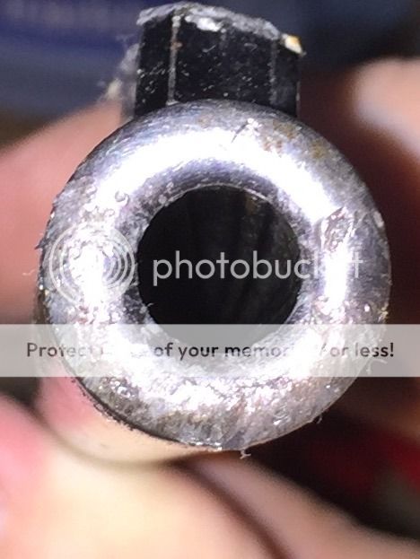

                  You need a new crown on that barrel and maybe a new front sight.

                    test its accuracy before any work is done its probably fine

                      Well looking at the picture looks like there is a nick on the rifling bottom right at the 4 o'clock position.
                      I would definitely recommend crowning that along with the stock repair/replacement and new front sight.

                        Thanks for the input. I will get the stock replaced, and both sights are done. Any clue how much to re crown here in nor cal
