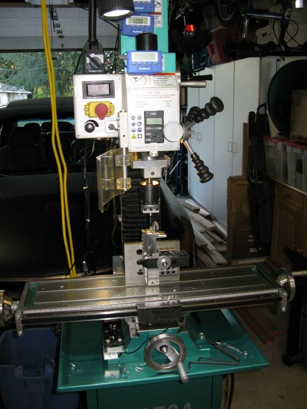

    First, I started with a Blackhawk Charger Axxiom Stock. Here is a pic of doing some of the machining on this thing to convert the stock from a pistol to a rifle configuration. Actually, this was more like exploratory surgery or machining on my part.

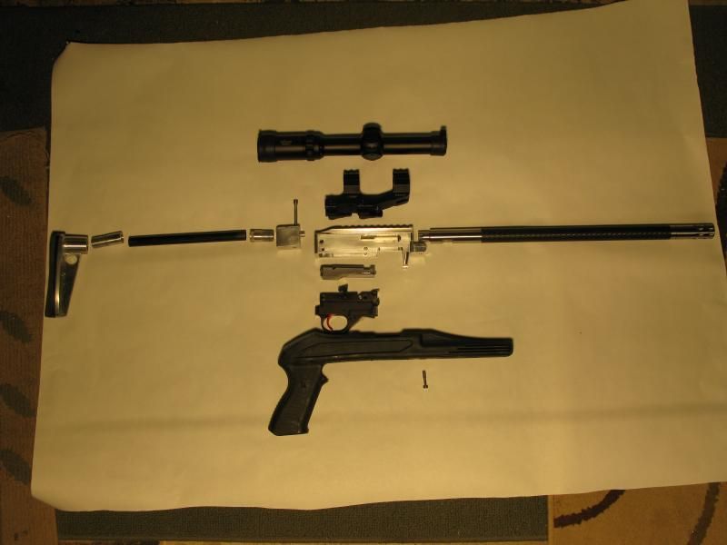

    I really wanted two (2) takedown screws to attach the receiver assembly to the stock. This meant I needed to make an adapter for the rear of the receiver. This adapter was also used to attach the carbon fiber rod for the stock / buttplate assembly. Here is an exploded view to give you an idea of what this is all about.
    Here is a pic of how I used a boring tool to bore out the main barrel hole. I bored this thing out about 0.0015" smaller in diameter than the barrel tenon. Yes ... I did measure EVERYTHING ... Just as Randall and KCSTOTT recommended!

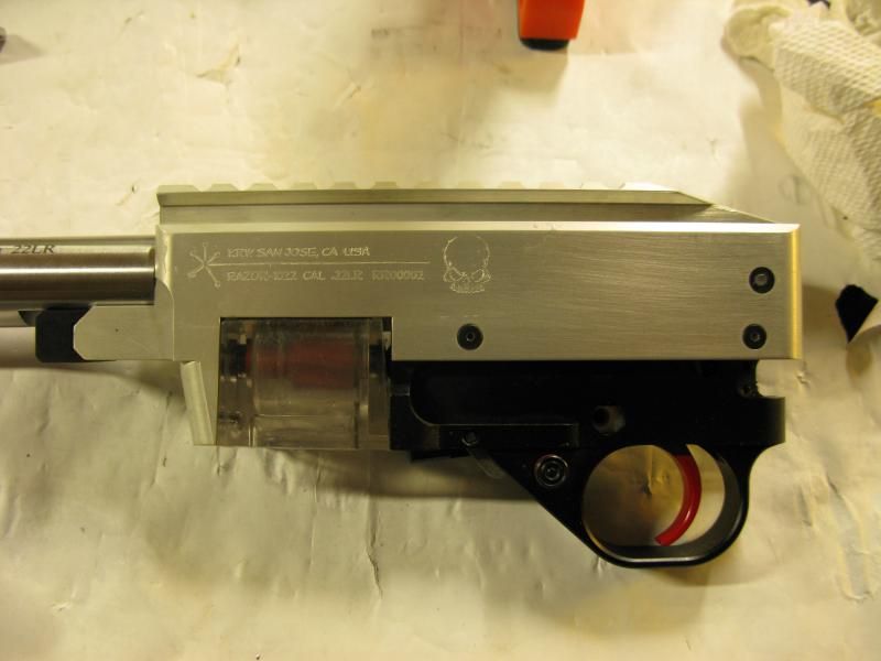

    Here is a closeup of the finished receiver with the barrel and trigger group installed. I did an electrochemical etch to get the serial number and other stuff placed onto the receiver.
    The barrel is a Volquartsen THM Carbon Fiber barrel. I got it on sale over at Midway. Unfortunately, I really wanted the forward compensator as shown on the link. Midway did not sell this option. However, Scott Volquartsen was very accommodating and told me all I had to do was send the barrel to him and pay for the compensator + S&H and he would put one on for me. The trigger group is the KIDD two-stage trigger group.
