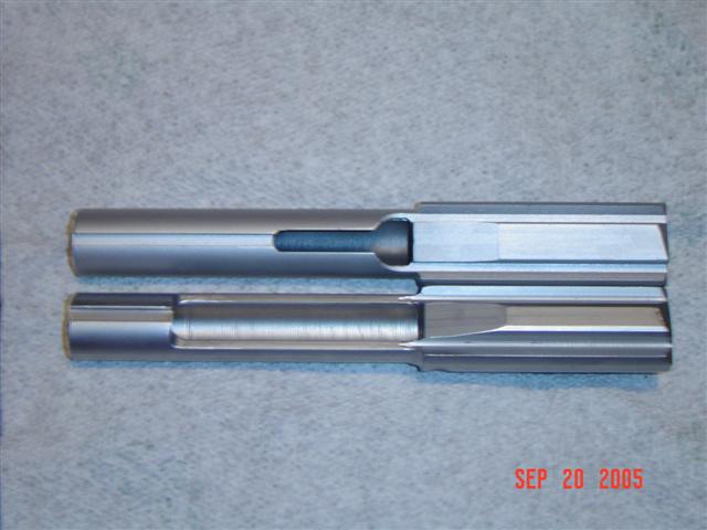

                      The problem he describes leads me to believe the FCG pocket was machine off center and shifted the BCG over at the rear causing it to bind up.
                      Now I find that hard to believe as the front take down lug would have to shift as well. The only other issue is the receiver extension thread could be off center but that would be easy to identify.
                      Once again Brake out the calipers and get your print and check the damn thing.
                        I'm trying to comprehend how moving the FCG pocket in the lower would move the BCG in the upper.
                        Have you compared the hammer width to the width of the hammer clearance cut inside the BCG?
                        Perhaps you are thinking of an old style armalite carrier with the really narrow clearance cut?
                        If the FCG pocket was grossly mis-located, the hammer would just strike the bottom of the carrier instead of the firing pin.
                          No just that the rear lug pocket is typically machined with the FCG pocket and if it was shifted over say .030" may cause a bind with the bolt rubbing the buffer tube. Yeah all your BCG now a days have a mile of hammer clearance. and you've been doing this far longer then me. I had no idea about a "old style Armalite.
                          but like I said that can't happen as the front lug would have to shift as well.
                            If you had said above that the rear lug pocket location in the lower would shift the upper, I would agree, but you specifically said FCG pocket...
                              I did a google search to find a photo of the old style and new style 308 carriers and it turns out the damn photo was on my own website...
