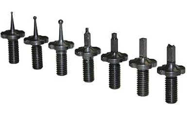

      You can try changing out the front sight post. The picture is a set of KNS Precision front sight posts... I ordered mine from Amazon and I really like the ball sight post (the smallest one)... I know it is not free like modifying the post but this will give you options...
