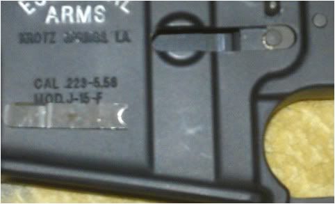

                            Mag catch broke right at the midpoint where the post connects to the bar.
                            That is the mag catch covering the SN

                              Well that one was defective!! Wow.
