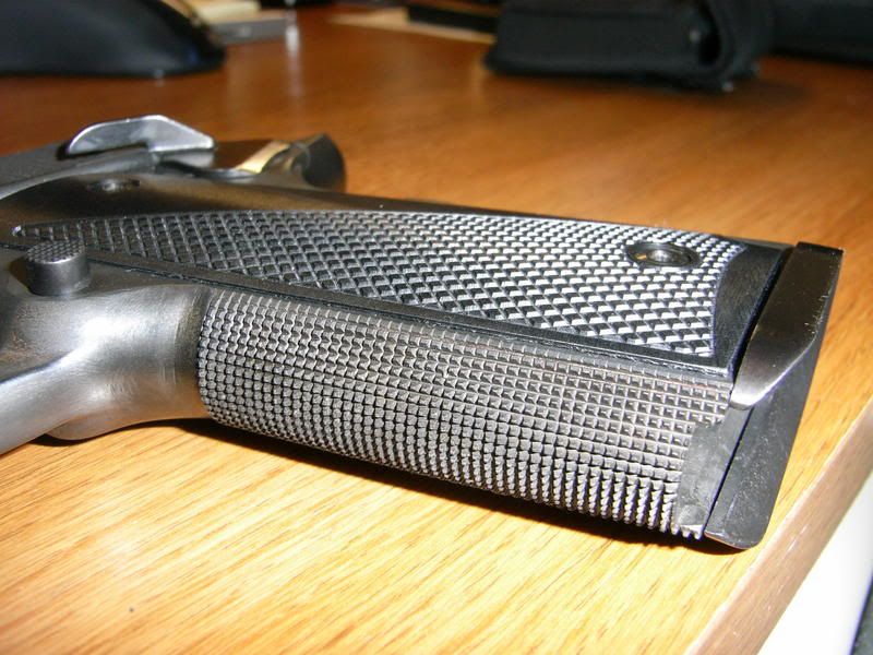

          sa champion
          • 386
          I did that on all my three 1911s.
            bigkahuna04
            • Mar 2007
            • 913
            that looks great... did you use a chekering guide? and what type?
            NRA Life Member
            "Comparison is the thief of joy" T. Roosevelt
            "The rifle itself has no moral stature, since it has no will of its own. Naturally, it may be used by evil men for evil purposes, but there are more good men than evil, and while the latter cannot be persuaded to the path of righteousness by propaganda, they can certainly be corrected by good men with rifles." J.Cooper
              tzahoy
              • Jan 2005
              • 449
              I bought a Brownells fixture that had been used once. I've done two of my 1911s with it, an Officer's model and a Gold Cup. I had to modify the fixture to do the Officer's model due to the closer grip screw spacing. Both came out cherry. The first one I did probably took a total of ten hours. Laying down the first lines is absolutely critical, if you screw up here there's no fixing it. The second one I did probably tok a total of six hours. I look at what gunsmiths charge to hand checker a frame and it's too cheap.
