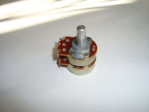

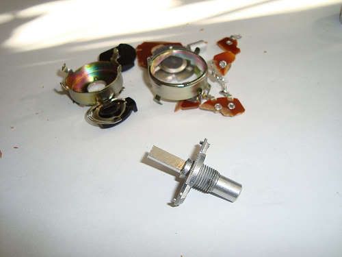

    The project began. Make my own. It can't be that hard, so like all good ideas, I started at Radio Shack, where I bought a Potentiometer and a simple knob. Disassembled the potentiometer to the body and shaft that was needed (note this a pic of the second one I'm trying to simplify the process, not the one I started with (future pics):

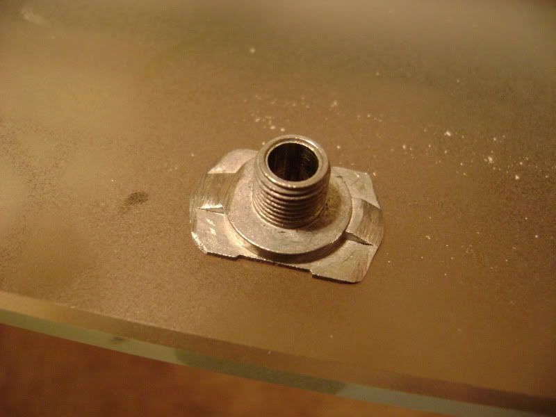

    From there, it was doing a little grinding on the body, to get it to:
    - get it to fit within the scope cap
    - Flatten a "nub" on the bottom of it
    - Remove/smooth some extra "bumps" (all technical terms)
    *obviously this last pic is further down the line, but wanted to show everything fit.

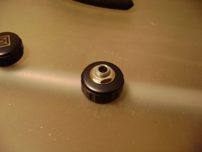

    From here, the shaft of the potentiometer was filed to thin the blade to fit the "coin slot" on the scope turret until it fit easily, but still snug.

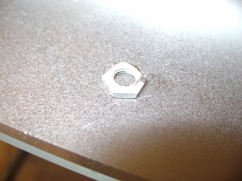

    After some hard-core thinking to simplify the next issue, in the end, it worked out. The shaft goes in perfectly, but in real use, how do you keep it from falling out? The shaft as it sits in the potentiometer has a tab at the end that locks it in, but that was removed during disassembly (and really wouldn't have been used anyways). So...remembering I bought a tap & die from the almighty Harbor Freight about a year ago, found the correct die, said a small prayer since I'd never done this before and cut threads for the shaft (barely seen in the pic above). A stop at Lowe's for the right sized nut was easy, but it was thick standard M5-0.8 nut and so, the gunsmith's friend (Dremel) came out and I flattened it.

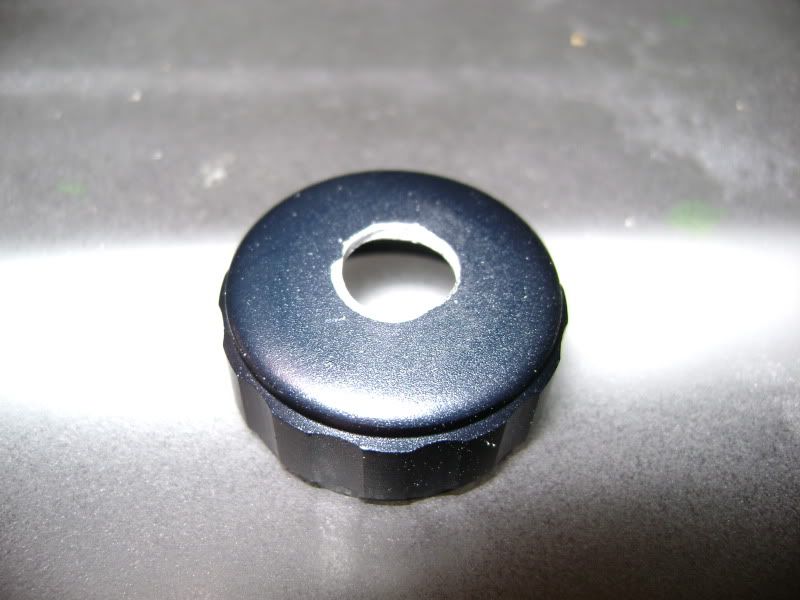

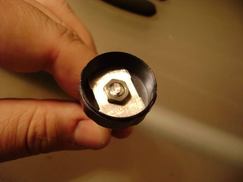

    Now for the point of no return. Drilling the scope cap. This had to be done, so starting small & increasing or using a stepped bit, is your friend. Here's the cap post drilling and then the whole she-bam assembled:
    The nut on the top is from the potentiometer.

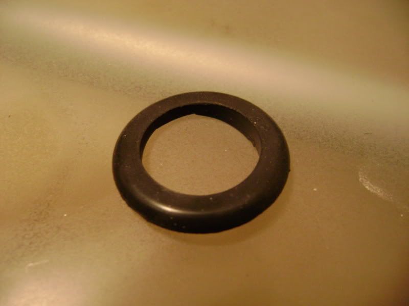

    So...given the thickness remaining of the nut and the shaft, there was some distance that needed to be made up. I'm not going to try and make a sleeve or anything of that nature and picked up a grommet (Lowe's) and cut it in half to make it thinner and make up the distance as well as provide a water-tight seal.
