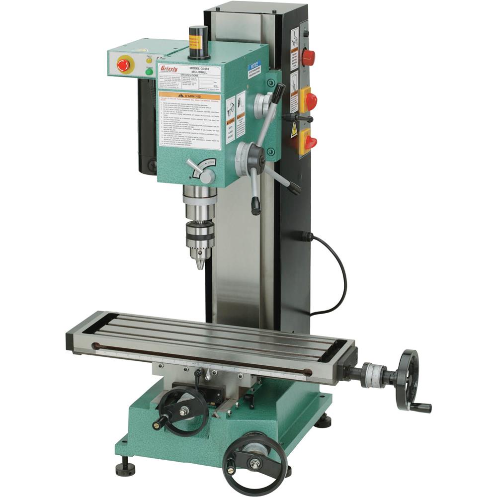

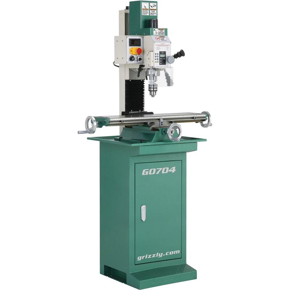

              I'm going to order one of these:
              My issue with the Square Colmn is the very short Spindle travel
              The 463 is 3.3" and the 704 is a mere 2" which means I will have to raise and lower the head constantly.
              The only draw back I see of the RF-31 is having to move the Head on a rare occasion, it has 5" of Spindle travel
              Input please
              G0463 6" x 22" 3/4 HP Mill/Drill Premium features on this mill drill without the premium price. The G0463 3/4 HP Mill/Drill comes with standard features that even some larger mill/drills don't have. The most notable feature is the two-speed gearbox with variable speed for precise spindle speed control. The G0463 features an R-8 spindle taper, which only accepts R-8 collets. R-8 collets come in many sizes, typically ranging from 1/16" to 7 /8" and 3mm to 20mm. The table has three 7/16" T-slots for locking down your workpieces and a coolant trough to recirculate the coolant that helps keep your bits from overheating. The cast-iron dovetail column improves precision and the gibs are fully-adjustable to take play out of the table, cross slide and column. The G0463 has a coolant trough, reversing switch, and easy to read dials with inch-cut leadscrews. For a compact machine, the G0463 has some serious heft at 445 pounds. With all these features and mass, you'll be able to mill, drill, bore, and ream through the most serious hobby projects you can come up with! As one reviewer on grizzly.com mentioned, the 3/4 HP Mill/Drill is a “Very nice machine for the money.” Like all of the Grizzly Mills, the G0463 comes with a 1-year warranty covering parts and assuring the unit is free from factory defects. (Consumables are not covered by the warranty.) The G0463 manual was written by our U.S. based Technical Documentation Department and is packed with useful information. The complete and easy-to-read manual makes it easier to assemble and maintain your mill drill. The Grizzly Customer Service and Technical Support Teams are U.S. based. Parts and accessories for the drill press are available online and shipped from the Grizzly parts warehouse in Springfield, MO. Made in an ISO 9001 Factory SPECIFICATIONS: Spindle motor: 3/4 HP, 110V, single-phase, 7A Spindle travel: 3-3/8" Max. distance spindle to table: 14-3/4" Max. distance spindle to column: 9" Longitudinal table travel (X-axis): 15-7/8" Cross table travel (Y-axis): 5-3/4" Vertical head travel: (Z-axis) 14-7/8" Drilling capacity: 1" Table size: 6-1/4" W x 21-5/8" L x 1-1/2" T T-Slots: 3 @ 7/16" wide on 1-11/16" centers Spindle taper: R-8 Spindle speeds: Variable, 0 - 1000 RPM (LOW), and 0 - 2000 (HI) Quill diameter: 2.362" Overall dimensions: 27" W x 30" D x 30-3/4" H Approximate shipping weight: 445 lbs. FEATURES Dovetail column with elevation handwheel graduated in 0.0005" Variable spindle speed from 0-2000 RPM Push button emergency switch with indicator lights 2-speed range gearbox Reversing switch Coolant trough Dial speed control
              G0704 7" x 27" 1 HP Mill Drill with Stand Grizzly's best-selling Mill Drill. The G0704 7" x 27" 1 HP Mill Drill with Stand can be used as a dedicated, single-purpose machine in a professional shop. It can be easily operated by those just learning to mill in their home shop as well. It is an excellent value and has some of the same features found on much larger mill drills. That’s why it is one of the best-selling mill drills in the country! The variable-speed 1 HP motor powers the R-8 spindle from 50–1125 RPM in low and 100–2250 RPM in high. Spindle RPM can be monitored on the convenient digital readout. A clear chip guard on the spindle keeps debris from flying at the operator. The large 7-1/16" by 26-5/8" table can be moved by handwheels in both the longitudinal and cross directions. Both feed directions can be locked by table lock levers. The G0704 also features tapered gibs with double locks which adds accuracy and rigidity, a dovetail column; and it comes with its own stand. The G0704 manual was written by our U.S.-based Technical Documentation Department and is packed with useful information. The complete and easy-to-read manual makes it easier to assemble and maintain your mill drill. Parts for the mill drill may be available online and shipped from the Grizzly parts warehouse in Springfield, MO. Made in an ISO 9001 factory SPECIFICATIONS: Motor: 1 HP, 110V, single-phase, 12A Spindle taper: R-8 Spindle speeds: Variable, 50–1125 RPM low, 100–2250 RPM high Max. distance spindle to column: 7-1/2" Max. distance spindle to table: 13" Spindle travel: 2" Drilling capacity: 5/8" mild steel Vertical head travel: 11" Column tilt: 90° left/right Table size: 7-1/16" x 26-5/8" Table travel (longitudinal): 18-7/8" Table travel (cross): 6-7/8" T-slots: 3 @ 2-1/2" centers, 7/16" wide Stand footprint: 15-3/4" x 16-1/2" Overall dimensions: 38" x 34" x 67" Approximate shipping weight: 372 lbs. FEATURES: Spindle RPM DRO Spindle depth display Fine feed head control 2-Speed gearbox 3–16mm B16 drill chuck Clear guard on spindle Cast-iron dovetail column Rubber chip guards on ways Zero setting dials Dials read inches Forward/reverse switch Start/emergency stop buttons 1-year limited warranty Need help?We offer U.S.-based customer service and technical support to
