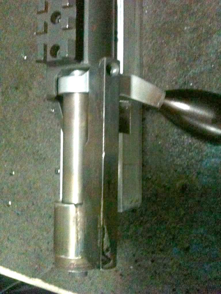

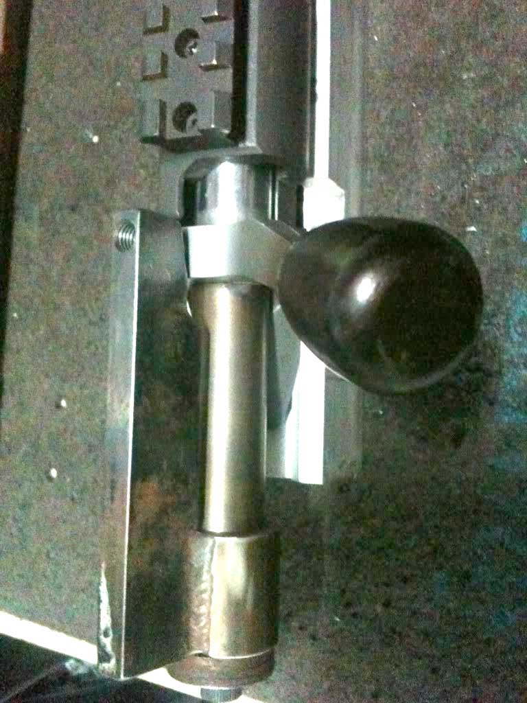

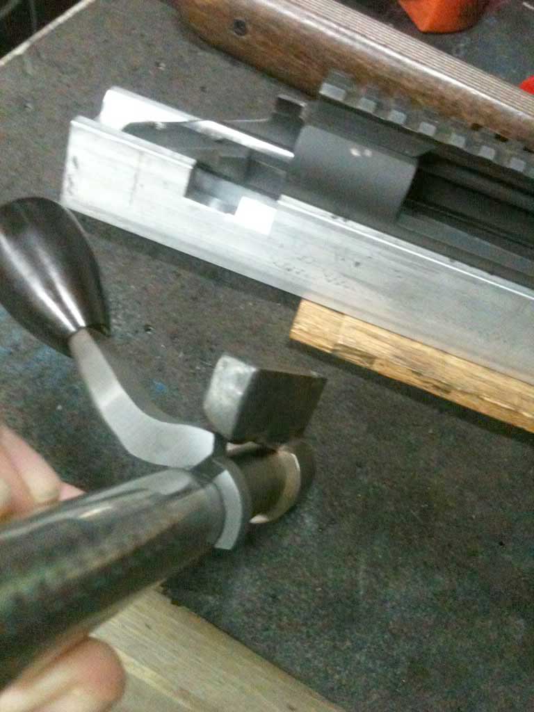

                    ar15barrels
                    • 57103
                    Here is the fixture I made to hold bolt handles in alignment on the bolt body so I can check timing and alignment in the receiver before welding them:
