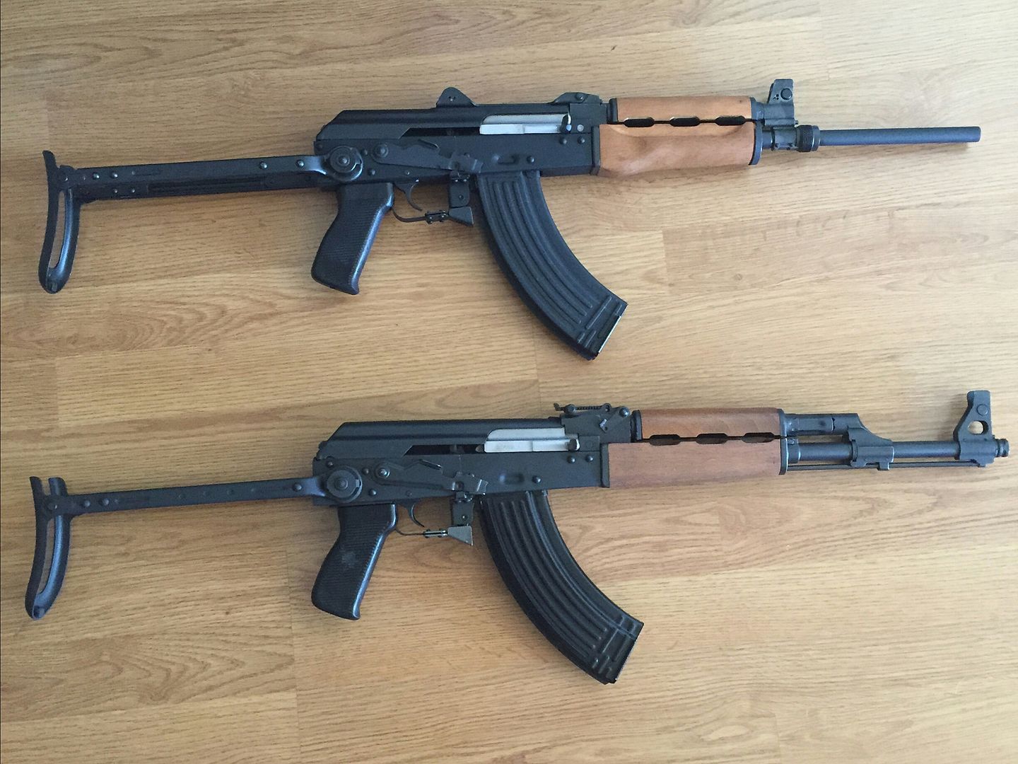

            Build a hybrid. A yugo 1mm slabside front end and either a polish or Hungarian UF rear end

              The bottom NPAP build is a hybrid
