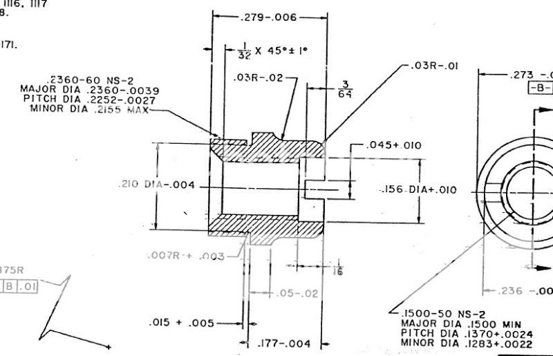

                    tr6guns
                    • 643
                    Standard Bushings are .236"-60. Use 7⁄32" tap drill for bushing.
                    Grip Screws themselves are .150"-50 x .250" tpi

                      So a standard bushing is .236"-60 this is the grip screw , not outside bushing thread ?
                      Would you know what tap size is for a standard grip bushing ?

                        Thank you , while I have that magazine , I never saw that info .
                        I ordered the bushings . They came but between the Flu , Christmas and new years - they are just sitting here . I found the tap
                        And can probably use either crocus cloth or may 600 grit emery cloth to reduce size .
