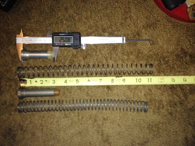

                  gemini1
                  • 2230
                  Here's my LR308 and AR15 carbine buffer and spring. The 308 spring has 29 coils and the buffer as you can see, is 2.508" Im using a standard AR15 buffer tube ( 7" measured from the inside) on my 308.
