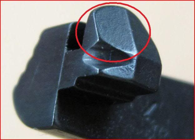

                  Bingo!
                  See attached images (sorry for poor quality!).
                  I was finally able to do this using a variation of the second video.
                  Thanks for all the suggestions. Appreciated!
                  Now that I have figured out how to do it with THIS PARTICULAR 1911 (Springfield Armory Loaded in .45acp), it should not be a PITA.
                  Variation from the second video- with the short part of the guide rod, which is threaded, the spring must be attached to it before moving the slide back to insert the slide stop. One can not drop the spring in later as in that video and with other .45's... at least not if one wants to later attach the front part of the guide rod.
                  So, it's basically a normal reassembly- barrel, recoil spring and shorter guide rod (threaded) in the slide (BUT with NO BUSHING attached to barrel), attach slide to frame and get that slide stop inserted into the frame, move slide forward and apply thumb safety so the slide is locked...then, place guide rod/recoil spring plug on exposed spring, apply downward pressure on it but press down hard and try to get it flush, or even deeper (I used the suggested 'penny trick'), then insert the muzzle brake as in the video.
                  Again, and with the SA Loaded, at least, that recoil spring must be attached to the smaller guide rod first- it goes in snug and the guide rod does not rest well under the barrel without the spring attached to it. Owner's manual clearly depicts spring attached to guide rod in the slide for reassembly. I couldn't do the procedure without the spring already in the gun and attached to the smaller guide rod because the slide would not go back very far, if at all, and spring needs to be attached to the threaded GI-style guide rod using two hands; I make that comment because my gun has never been fired and once the recoil spring breaks in things may be different.
                  Thereafter, and with the slide retracted and locked open, I was able to screw in the longer portion of the two-part guide rod to the face of the guide rod plug,
                  though I would imagine it not mandatory.
