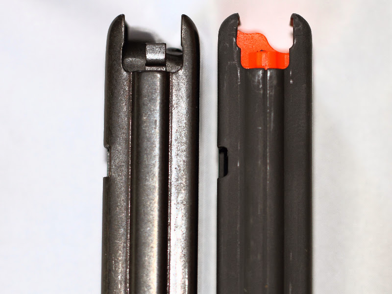

    My 10/32 ASC mags run OK in my PSA kit and so does my 10rd ASC mags. But check this thread - it is also discussed on other forums, seems to be a useful mod. I might mod one of my ASC mags this way just to try anyhow.
    Here is a Metalform (left) compared to ASC
