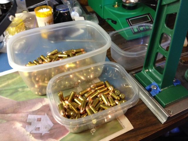

                  'ol shooter
                  • Mar 2011
                  • 4646
                  Honestly don't know why I would need to tumble these again.
