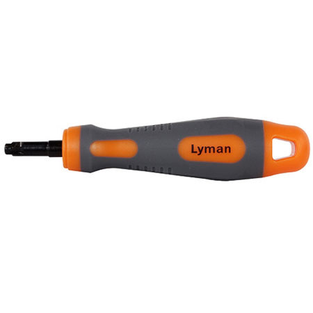

                      There's several ways to remove the crimp on 223/5.56 primer pockets. Military brass will always have a crimped primer pocket, which will always need to be removed before the brass can be reloaded.
                      You can get something like this LE Wilson chamfer tool
                      Or you can go fancier and buy a motorized case prep device. Really up to you, your budget and your needs.
