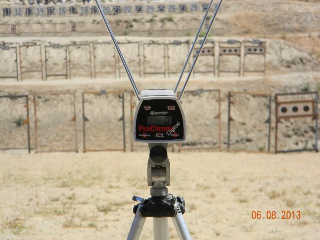

                            Got this one and it works great. Competition Electronics ProChrono $99. I just order the software and cable to control remotely and display strings, power factor, ft/lbs, hi/low, avg etc. So for a $150 you get a great chrono with remote and software to track and display information. A+
