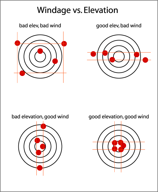

                              I did some more illustrations to teach this stuff...
                              First, Accuracy vs. Precision:
                              If you are not first both precise AND accurate, you can't really get into the good stuff of precision shooting where things like brass and loads really matter.
                              Let's assume you HAVE reached the point in your shooting where you can call your shots and you KNOW when something is right and when something is wrong.
                              THEN you can look at this illustration of a target at 400yds or more and it will make more sense:
                              You have to be shooting at longer distances to really see the patterns above, but when you do, the following rules generally apply:
                              Stringing on the horizontal axis is purely wind compensation skill.
                              As you get better at doping the wind, your groups will shrink on the horizontal axis.
                              Stringing on the vertical axis is caused by velocity variation (also measured as ES if you use a chronograph).
                              As you tighten up your ES, your groups are also capable of shrinking substantially.
                              There is another factor here as well, tuning the load to your barrel.
                              You can have really low ES, yet still see vertical stringing.
                              This is usually caused by your load not putting the bullet release at one of the ends of the barrel's harmonics.
                              When you find the best load via a ladder test, you are finding a load that releases the bullet at the top or bottom of a node.
                              This makes the gun more tolerant of small pressure variations.
