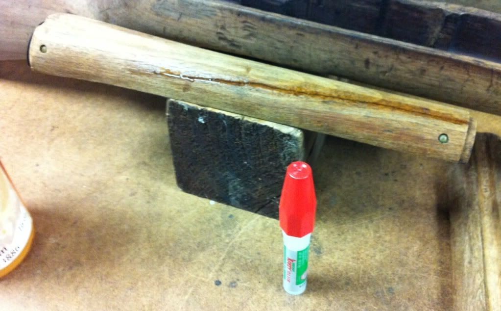

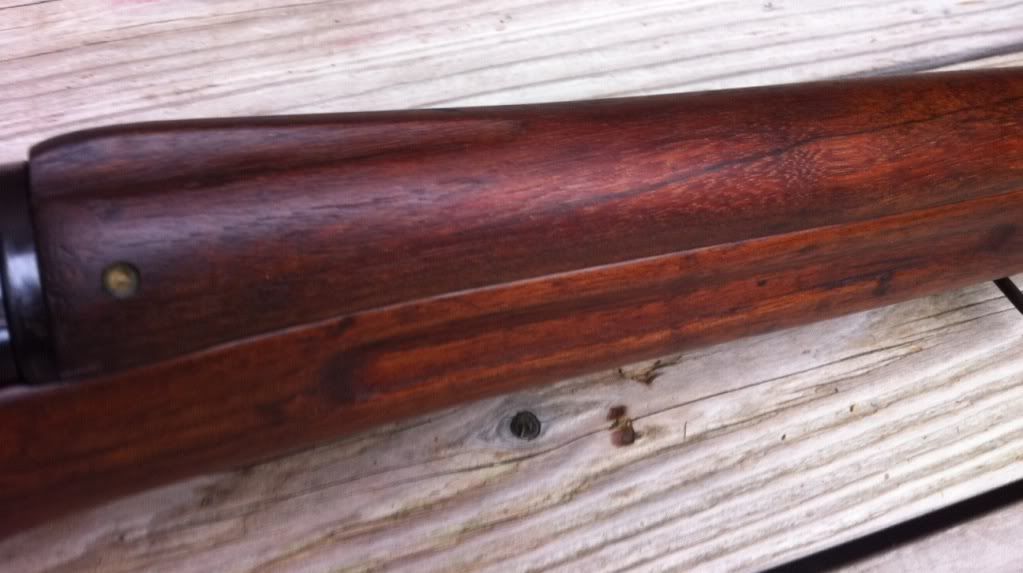

          Squirt some liquid super glue (not gel) into those cracks & clamp it up tight. Lightly sand and refinish the stock and you should be good to go with no damage other than some small dark lines.
          Here is a crack I repaired using this method on a M1917 rifle handguard:
