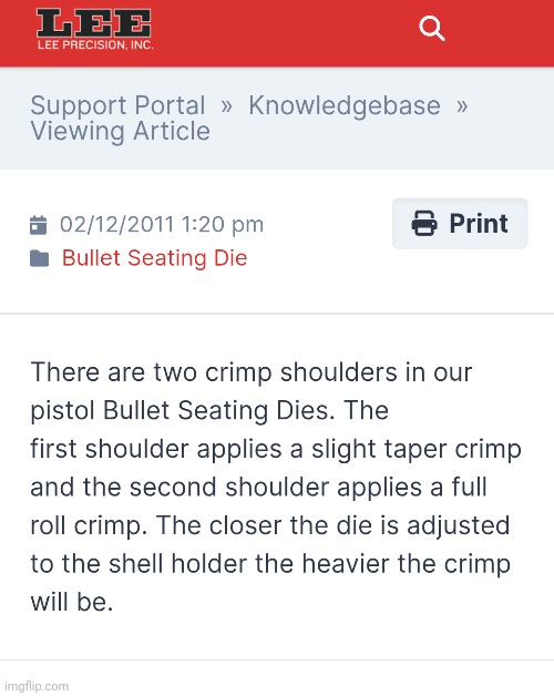

              OMG. I just managed to connect to this godforsaken website, login, and (bonus points) FOUND the quote button! Buckle up buttercups, you're in for a helluva a cyber-ride! First:
              Originally posted by Sandspider500
              That's weird.
              I wonder if the other die makers have the same thing.
              Thankyou Sandspider500 for digging out that Lee Precision Technical Support Post (LP TSP). That info is not weird. Considering the arrogant, ignorant, and narcissist (AIN) cacophony that has risen here from the tire kicker, nose picker factions of CGN, your posted information is GOLDEN!
              First, Mr. Rausch:
              "I doubt that's correct.
              I have never heard of any reloading die maker providing roll crimp dies for cartridges that headspace on the case mouth such as 9mm/40/10/45acp as all of those cases need the belling removed and the case pushed back against the bullet in order to fit into the gun correctly."
              Well, maybe Mr. Rausch, you're not the most well informed, omniscient, gun-guru you consistently purport to be here..... Nobody knows everything about anything-including YOU. (More to follow, so stay tuned).
              So after a "rausching" start here, I must address that LP TSP presented above. I do so with a personal dedication to accuracy, ​completeness, and possibly to present a window toward Absolution for the AIN pukes that pollute these forums. Listen up, and recognize your opportunity to contrition.
              The author of that TSP stated that the dual crimp function was resident in the "Bullet Seating Dies". That TSP is dated in Feb of 2011. Either it was an error, or there has been a later design change to Lee Precision Pistol Die Sets (LP PCD).
              I purchased my LP PCD Sets in 2012-.40 S&W, .45acp, .45 colt....
              "Friends don't let friends use lee dies."
              Sorry "randall", but no one prevented me from utilizing LEE Precision products-family, FRIENDS, or CGN posters. And I can confidently state to YOU, that I and many others, through the benefits of natural intelligence, high-quality education, and experience-us Lee Precision "drivers"/CGN members here turn out "Stellar" examples of DIY ammunition. AIN again?
              And in all three sets of my 20212 LP PCD sets, that dual crimp function-"taper then roll" was now resident in the Lee Factory Crimp Die (FCD) via the carbide bushing in same. The dimensional relations and function remained the same, the closer the shell holder is to the die, the greater the crimp-taper and then roll.
              As for big mouth man, and mr. cheese.....take a good look at your LP PCD sets, or read the above.......maybe you'll learn something. But if not, AIN forevermore.

                      "Lee 40 S&W/10mm Auto Carbide Factory Crimp Die sizes the cartridge while being crimped so every round will positively chamber freely with factory like dependability. This die applies a taper crimp."
                      Pulled directly from:
                      on 2025-04-15 @1227 PDT
                      Or do I need to provide an APA style citation?
                      Should we start arguing that Lee's own description is potentially ambiguous (taper then roll still means taper)? How about arguing that if Lee was a GOOD reloading company it wouldn't be ambiguous? Or how about arguing that Lee IS a good reloading company and they aren't ambiguously defining their FCD because they are stating exactly what it does and only what it does?
