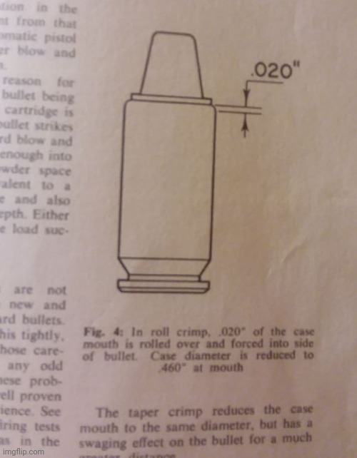

                Most seating dies will give a roll crimp, and will work fine if adjusted right. In fact in the early days the roll crimp was preferred. I use a separate lee taper crimp die, I feel like it gives a perfect crimp, I like .468.
                This is from a NRA handloaders guide from the late 60's.

                      Yes, but the die can be set to take the flare off the case. It doesn't have to be used as described in that old pamphlet.
