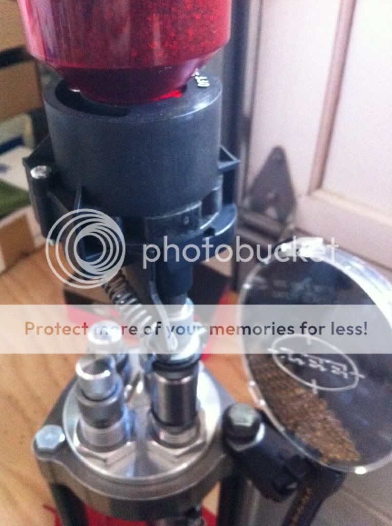

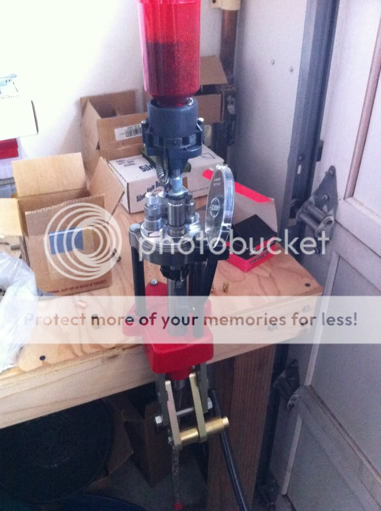

    So I was just in the garage reloading .40 S&W on my Lee Classic Turret when I heard a funny noise that came from my press I thought I had popped a primer but that wasnt the case. I checked the round fully and saw no discernible damage or inconsistencies and so continued to finish that round. As I started the next round and got to the powder stage I noticed that the powder measure wasnt dropping any powder into the brass. It seems that my auto disk is somewhat stuck. It will move a bit forward but will not go back far enough in order to fill with more powder. I took off the powder measure and then put it back on but that did not seem to help at all. Anybody have any ideas on what could have caused this?
    This is the press with the arm fully depressed.
    Closeup of the disk when the lever is down.
    Closeup of the disk when the lever is up.

    Is the disk installed with the tab in the groove on the bottom of the disk? Are the screws too tight?

      I loaded 50 rounds yesterday with no problem. I loaded fifteen today before this problem happened. Perhaps there's something wrong with the spring?

            take the hopper off and check the disk to see if the slot that the arm goes into did not brake . from what i can see the arm goes back but the disk stays so check the disk

              I noticed that when the arm comes up the spring only moves a little bit before stopping. I'm stuck at work for the moment but I'll see if I can't fiddle with it tomorrow. If I can't fix this should I call le customer service?

                    Did you turn off your powder hopper to troubleshoot? That would explain no powder.
                    Also noticed the brass nuts aren't installed.
                    I've had my LCT w/Auto Disc for 3 years now. I would occasionally get some funky operation from the Auto Disc. It's meant to have a bit of a "dink" when the disc retracts but occasionally it would get to be more of a "CLANG!" and sometimes would hang up that last little bit, stopping just short of full retraction.
                    I found that the spring was hanging up on the metal web underneath. It's a close fit and when the spring would shift it would hang up one coil short of retracting.
                    I took a Dremel with sanding drum and took just a hair of metal off the web. More of a rounding & smoothing so the spring would slide more smoothly & not hang up.
                    Supposedly the "dink" is to help settle the powder for more consistent charges but I monitored closely & am getting no measurable variation.

                      So I'm still not sure how this problem happened however I have found a solution. I simply loosened the screw on the spring mechanism and that solved it.
