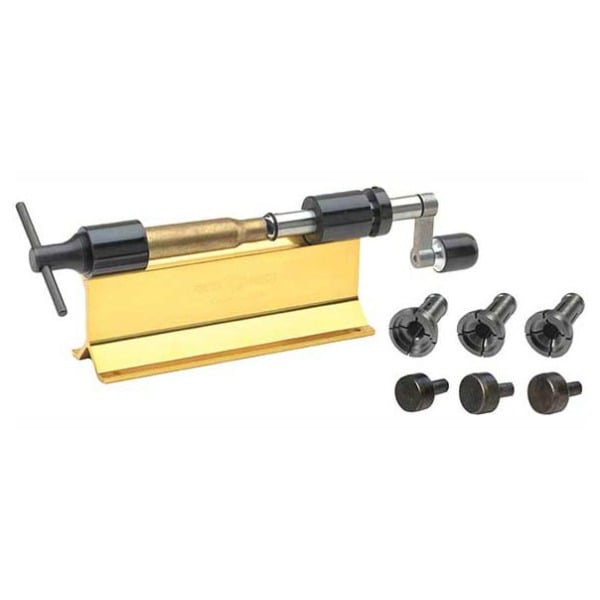

              Take a look at the Possum Hollow trimmers. Use a Wilson drill adapter and you can trim hundreds quickly and easily. Caliber specific. About $25.
                GeoffLinder
                • 2425
                The Gracey trimmer is just as good (IMHO) as the Giraud and $100 and change cheaper.
                The Possum Hollow hand trimmers do a pretty good job and can be chucked in a drill press to make it faster but they are still a 2nd level choice to Giraud or Gracey for best quality trim work.
                The Giraud, Gracey and Possum Hollow index off the case shoulder. The Giraud and Gracey also chamfer and debur and trim all at once. The Gracey & Giraud are far superior choices over a standard collet trimmer or the Dillon Power Trimmer, both of which index off the case head and leave square cut case mouths with sharp edges that make it harder to seat bullets and can scratch/gouge the bullet jacket unless you debur in a separate process after using a trimmer like this.
                If you are trying to load for precision I more than highly recommend a Giraud or Gracey if you want the best, and the PH trimmer if you can't afford the best but still want something a cut above the rest.
