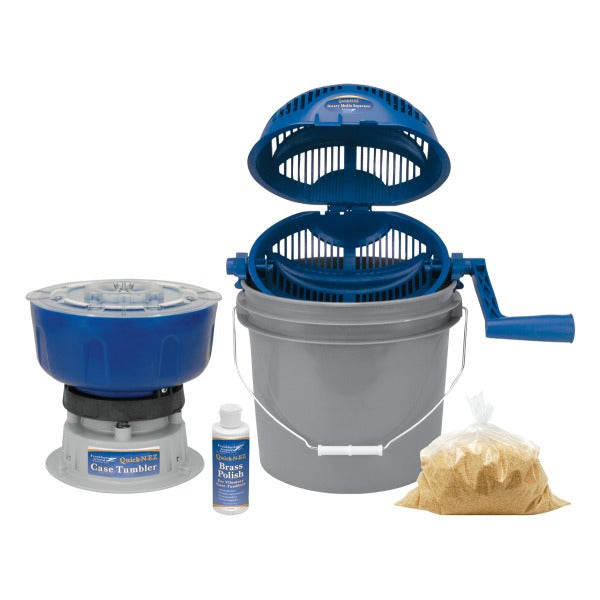

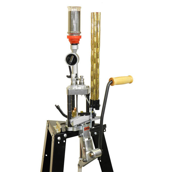

                    Here are some better deals on the equipment:
                    btw, Grafs only charges $5 for shipping regardless of how much is on the order. Coupon code "blue" may still take the $5 off.
                    The cost ends up about the same, but you get better (and more) equipment from a more reputable seller.
                    $160 - LEE PRO 1000 RELOADER 223 REM w/RIFLE CHG DIE
                    Lee Pro1000 progressive 3-Hole reloading Kit for 223 Rem. Includes press, PaceSetter 2-die set (Full Length Sizer, Bullet Seater/Crimper), 3-Hole Turret, #4 Shell Plate, Auto-Drum Powder Measure, Short Charging Die, Universal Case Feeder and Small Priming system. Note: This press may be used to load 5.56 NATO (5.56 x 4
                    $72 - FRANKFORD ARSENAL QUICK-N-EZ CASE TUMBLER KIT (Tumbler, sifter, media, polish)
                    Same great features as the Quick-N-EZ Case tumbler. Includes a Quick-N-EZ Case Tumbler, a Quick-N-EZ Rotary Media Separator, 4 oz Brass Polish, 3 lbs of ground Corn Cob Media and a Plastic Bucket for storing media between uses.Used in conjunction with Frankford Arsenal Walnut and Corn Cob Medias, the Quick-N-EZ Case re
