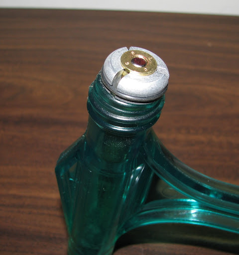

    As you can see, there are only 3 parts to a bullet puller. The handle, the collet, and the collet cap.
    The collet (or chuck) slips over the cartridge case and grips the rim of the case as shown here:
    The cartridge is then placed bullet-down into the bullet puller, and the cap is screwed on to hold the collet (and cartridge) in place:
    Note that there is absolutely nothing touching either the primer nor the bullet.
