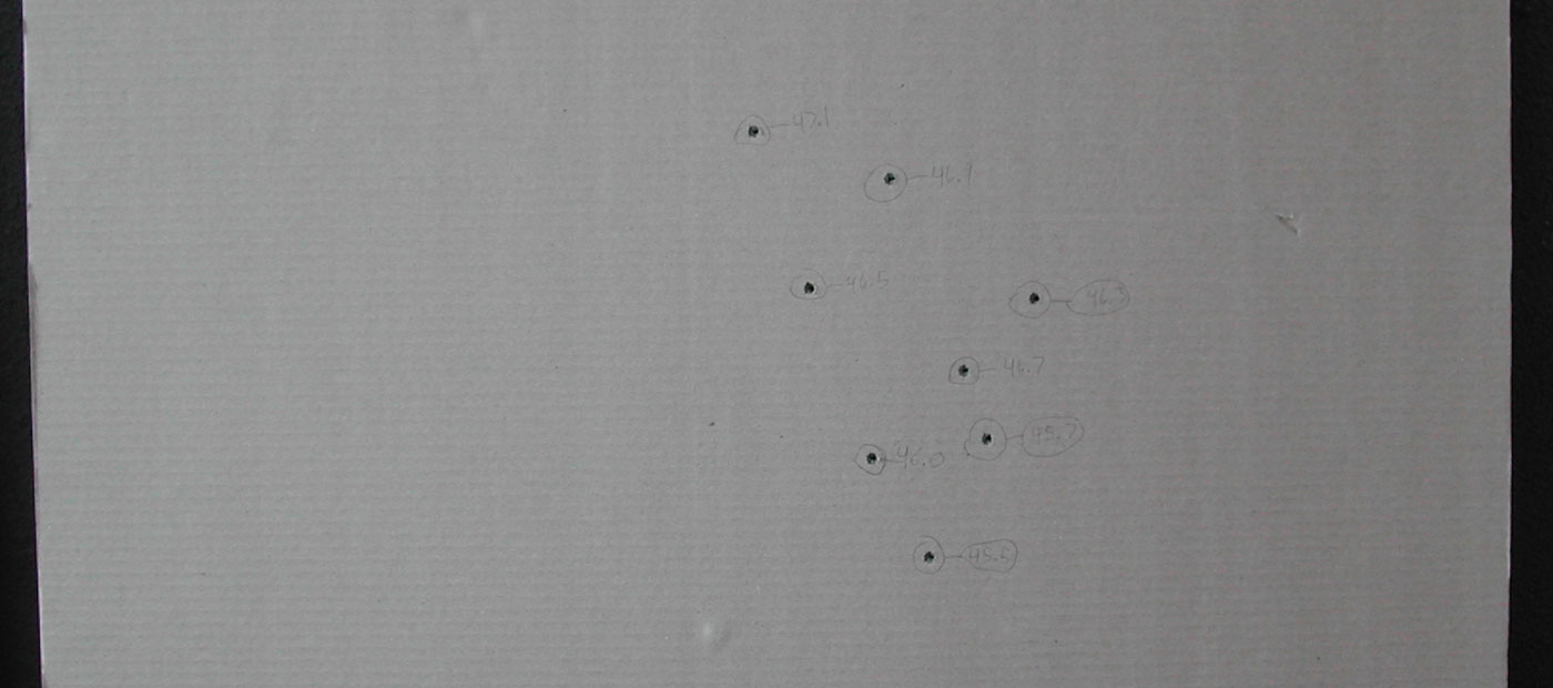

                          I was not happy with my 500yd ladder so I shot another one at 840yds.
                          That one showed much more conclusive results.
                          There were 4 rounds within about 3" of elevation while other rounds were showing 2"+ elevation change per 1/10gr of powder.
                          Here is my 500yd ladder.
                          I also have a couple rounds that I shanked and they landed out-of-sequence.
                          For reference, that cardboard is 36" wide.
