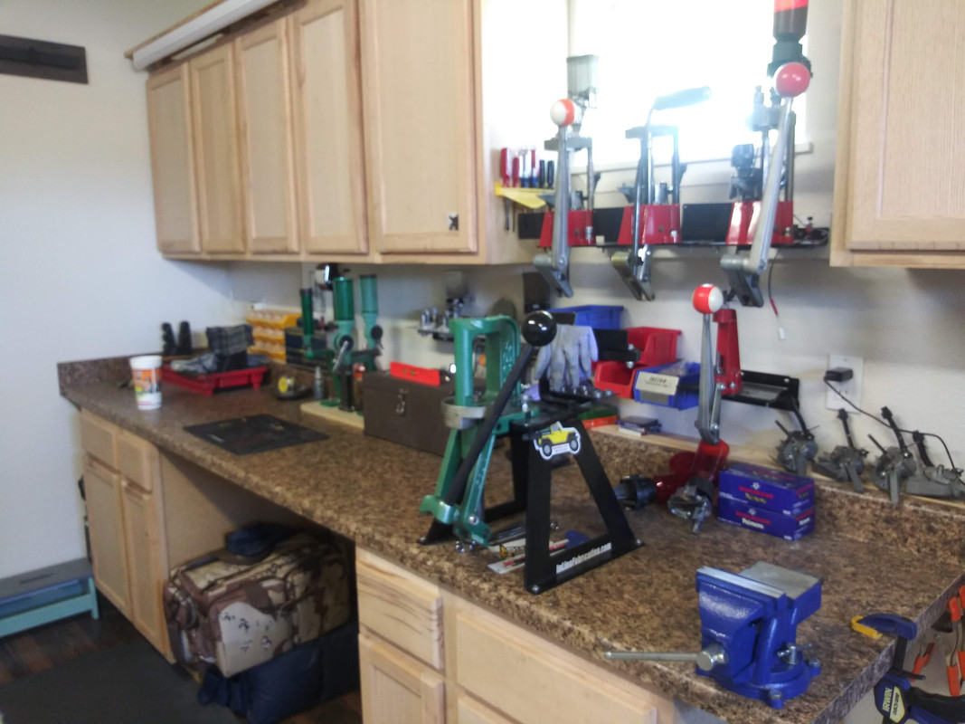

        Hey fellas, so I got the Lee pro 1000 setup to size and flare..I ordered the bench mounting plate for it. Do any of you know if you can mount the RCBS single stage Rock chucker to one of these bench plates?
        Thanks guys
          Thanks guys
          What bench mounting plate did you order? If you ordered the Inline, they make different plates for different presses that mount on their riser.

            Lee Precision 90251 Bench Plate Kit, Black
              Going from the description, it is only drilled to fit all current Lee presses and no others. I saw a few pics on Amazon that showed users that mounted the Rockchucker, so you might be in luck.
              I had a plate from Inline that fit a RCBS Jr., and I just drilled holes for a Lee press I had laying about. Worst case, you might have to drill some holes.

                golfish
                • 10129
                I'll take a look at it when it comes tomorrow. I also saw some of those pictures.
                I wonder if one of these will work, the plates kind of look the same. It could be that these are just for their own system.
                I decided to dump the Lee mounting plate and go with this system.
                These are the required top plates that lock into the InLine Fabrication Quick change mounts.   Select the ones you need...

                  golfish
                  • 10129
                  https://inlinefabrication.com/produc...ant=3591032516
                  This quick change mounting system is really nice.
                  I ordered the 4" tall bench mount and a plate for my RCBS Rockchucker Supreme and Lee Pro 1000.
                  It's something you guys might consider if you need an easy system to swap out presses. Its a real solid system.
                    Good call.
                    I bought into that system years ago and never looked back.

                      golfish
                      • 10129
                      Good call.
                      And you didn't tell me
                      It really is a good system and the cost isn't too bad for what you get.
                      The 2 plastic wing nuts that lock the plates down seem to be the only weak point. They're not the best.
