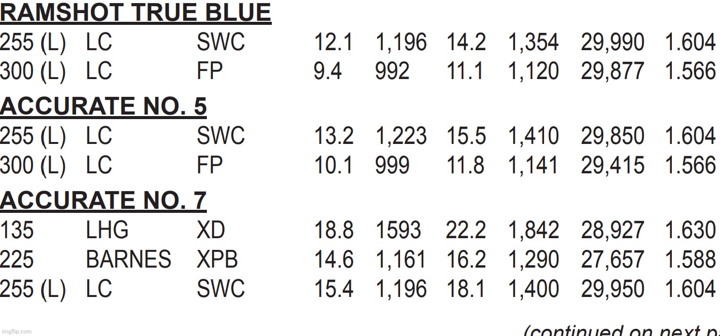

    I though that TrueBlue was supposed to be a cleaner burning alternative to Unique that actually meters

      I was thinking of bigger cases like 45win mag, Cassull and the 460S&W.
      I forgot that the Rowland was just a 45Super.

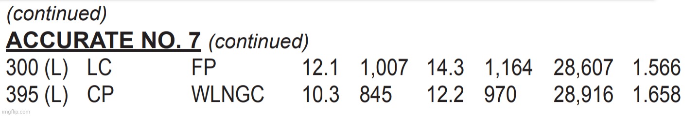

      In that case, I would be down towards Power Pistol and AA#7 as my 2nd powder choice because you could also hot-rod the 45Colt with those in a Ruger.
      Yeah two powders would be better, A universal powder like you siad. W231 Unique and the like then something more suited for the heavier slugs.
        If you had a Ruger or similar you could giver the onions with True blue and be around the same as aa7.
        But, for my Ruger and heavy slugs I use a much slower powder.

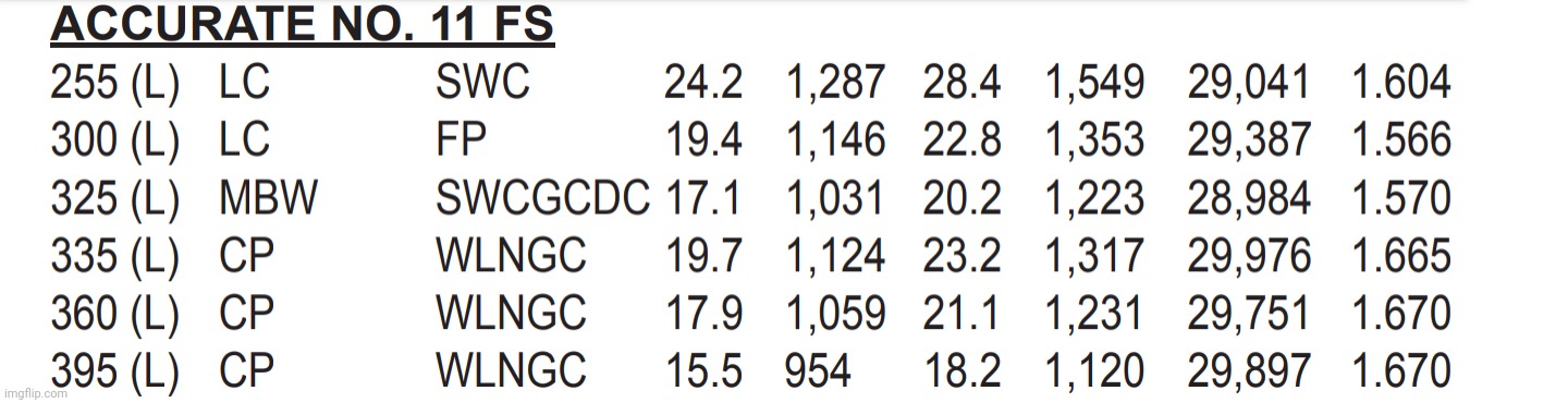

        But for pistol loads I have hs6, longshot, power pistol, be-86, 2400, aa5, 800x, cleanshot, bullseye, 296, 11fs, TCM, CFE pistol, hp38. What can I say, I like variety. I haven't had any unique for a few years and I can't see myself buying any for $40-$50 a pound.
