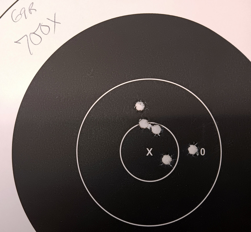

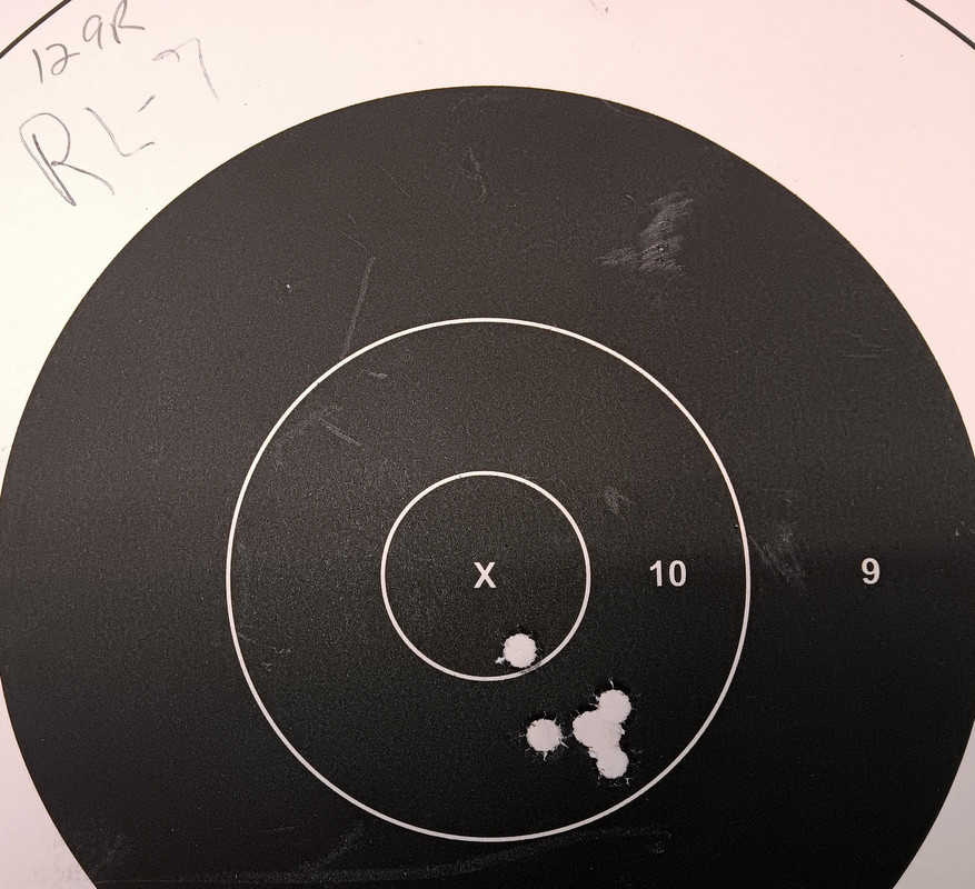

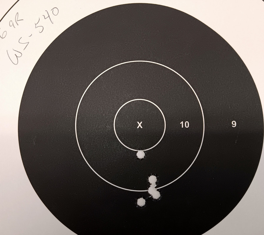

    I have been collecting old reloading manuals for a long time now - partly because I like to read them, but mostly because I shoot "obsolete" calibers and have some oddball powders on-hand (Alcan AL-5, W540, etc.).
    The the older books come in handy, because they will have load information for powders and bullets that are no longer in production. For example, I've found excellent loads for .38spl using w540 and AL-5, and excellent loads for 25-20 and 32-20 using non-standard powders for those calibers.
    For instance - I've been using 2400 for my 32-20, and it as well as 4227 are the "go-to" powders for this caliber. I did a bit of researching in my old reloading manuals, and found recipes for Bullseye (not surprising), 700X (mildly surprising), W540 (surprising), and RL-7 (really surprising!). Since I had all of those on-hand, I worked up loads for all of them, and took them to the range to test them out. It turns out, RL-7 was the clear winner, with a nice tight group at 50 yards out of my Winchester 1892. I never would have guessed that RL-7 would be suitable for a pistol cartridge like 32-20 and 25-20, but there are established loads for them and it works really, really well.
    In this time of powder and component shortages, it's a very handy thing to be able to put overlooked powders to good use. Even with prices going into the stratosphere, that pound of RL-7 only cost me $15, the 3 cans of AL-5 another $15, and the 3 cans of W540 $10.
