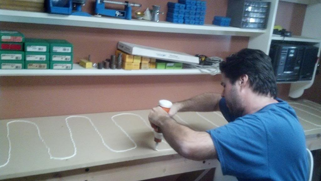

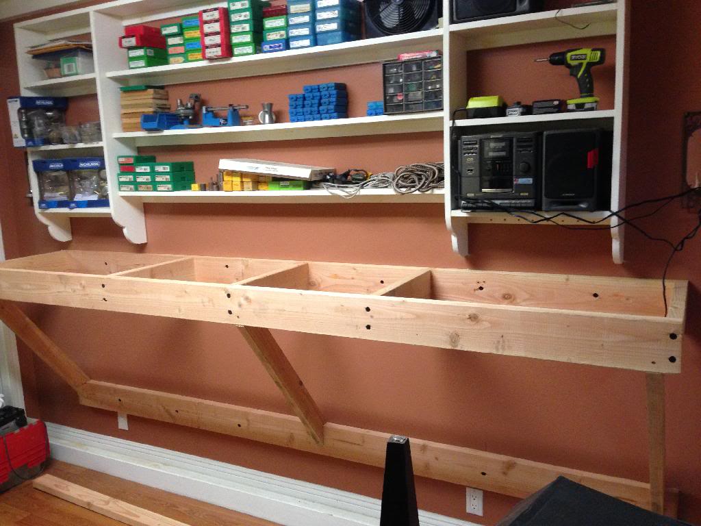

        I ran 4 dillons on a 12' countertop that I BUILT IN to 3 walls of a bedroom years ago and the presses were definitely too crowded with only 3 feet for each press.
        My current bench was built like this:
        Two layers of 3/4" MDF are glue limanated together after the bottom layer was screwed down so it is very solid and has no exposed screws on top.
