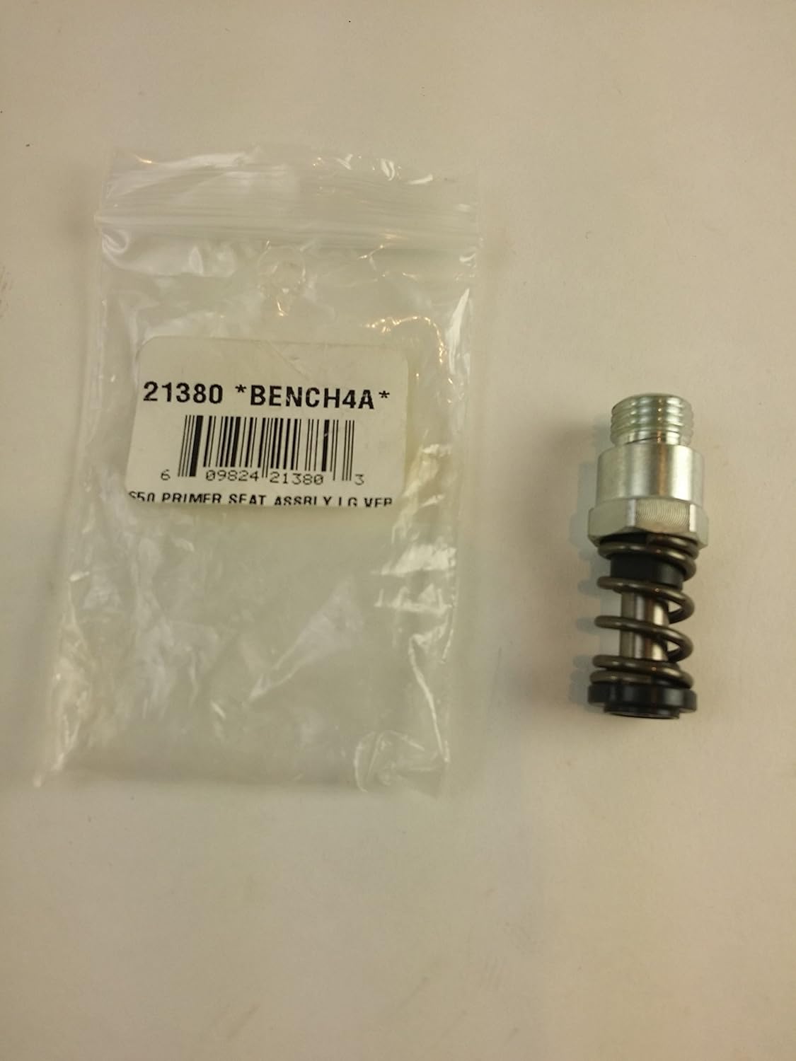

                Wich part is the seater the little metel tap the pushes primer
                Sent from my SM-N976V using Tapatalk
                  ar15barrels
                  • 57123
                  The seater screws into the bottom of the shellplate platform.
                  There are two different sizes, one for small rifle/pistol and the other is for large rifle/pistol.
                  You unscrew the small one and install the large one.
