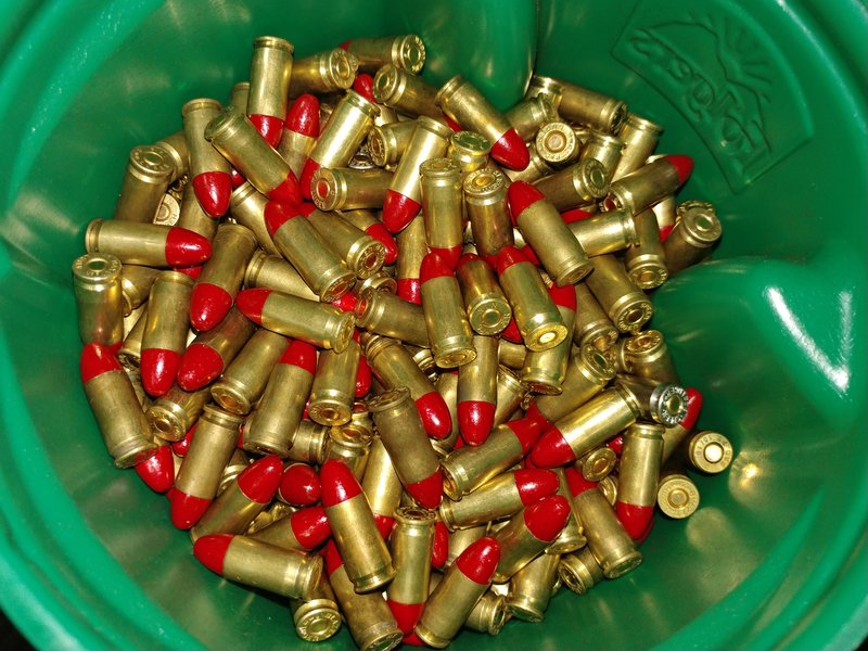

                    Pro #4:
                    500 124gr pills ready to go in under 4 hours, going slow...
