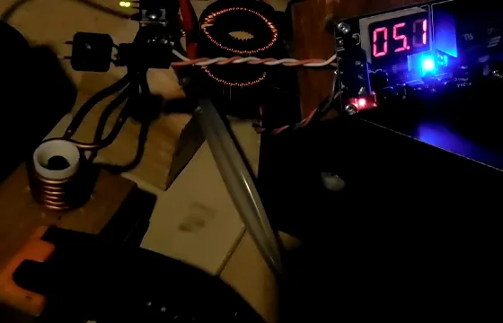

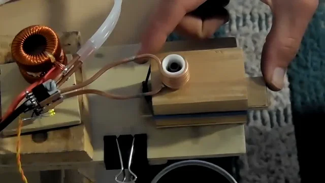

                      This is the one I had made for me it is rather simple I know, But I just had to open the box and use it..... so.... I have asked for his video so I will post it later. The selling point of this system for me was I can pick up a 308 case anneal it and then a 223 and then a 45-70 with out having to set the annealer each time to another case, You just watch and count until you get the result you are looking for then after the trial case you just count, I hold large enough cases with my fingers little cases with a cotton glove Tiny cases I made a holder, Just DONT admire the anneal to long or you will $%&*& burn your self
                      The coil heats the case in seconds most cases about 3 seconds set it down quick the heat will transfer through the rest of the case SOON. I use a thick steel plate to set the brass on to cool works great.
                      Pics, of mine the coil is water cooled hence the jar amazing how quick that jar of water heats up, This annealer has annealed THOUSANDS of cases
