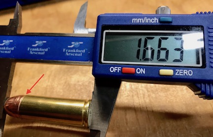

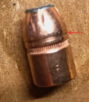

                  Ok.. So I made a couple dummies. First.. the bullet has a crimp cannelure as well as a second crimp groove:
                  When seated to the middle of the CANNELURE, the OAL came out at 1.663". That's too long for the Henry. It had to be finagled into the tube, and would not feed.:

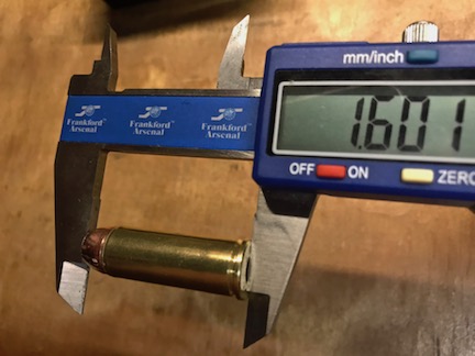

                  So I pressed the bullets farther into the case and re-crimped at the shorter crimp groove. OAL is right at 1.60" at that point, which is the specified max for 45Colt, and they loaded and fed fine.
                  So, I would say work up loads carefully with this bullet seated to OAL of 1.60", and watch pressure signs. It will most likely be a deadly s.o.b. on pigs :-)

                      I re-seated one more time at Speer's recommendation for seating in the rear cannelure at 1.640". My Henry still wouldn't eat it.

                            I was actually looking for more penetration than expansion to get thru the heavy bones and muscle of wild pigs. That’s why I initially asked about fmj bullets. There are a bunch of options for “defensive” hollow point projectiles but they are designed for a different purpose than I’m looking for. I want a heavy, flat point bullet that will stand up to relatively high speed for the caliber. Barnes xpb are supposed to penetrate as well as expand, no jacket to separate. Speers 300gr jsp would be perfect in my mind as long as they will feed in my rifle. Lehigh makes an extreme Penetrator that would be sweet, supposed to create big would while punching thru obstacles... but so would a plain ol RNFP fmj... dilemmas... going to call Speer right now about that second groove on their jsp...

                              Called Speer, and asked about the upper groove for crimping... his response was an ***-covering “we cannot recommend crimping in the upper groove as it may create over pressure issues, and we don’t have load data for that round in rifles.”
                              So could probably be done if one was careful to watch the primer for signs of pressure. For $15 for a box of 50, I’ll probably get a box and play with it. Start low and see what happens... worst case is they get loaded to 700fps and sent to their reckoning on my steel range.
