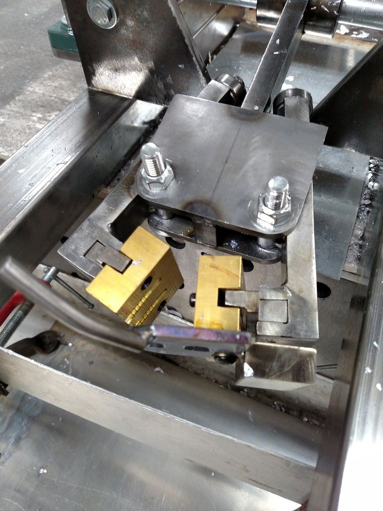

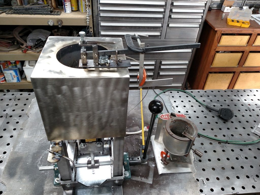

                              Here is a machine that another boolit caster made. I copied his machine and the commercial master caster machine. I have never seen one of these in person, until I built my own.
                              If you are really interested, you might have fun spending a few minutes looking through the the thread on building the machine: http://castboolits.gunloads.com/show...-master-caster
                              Right now, it is hand operated and you can buy a master caster for $1,000 if you have more money than me but lack the time or skills to build your own. The automation part is in the works and another person has a touch screen and plc setup which seems to work great and is written just for these machines.
                              The master caster is blue just like the dillon presses and it works like a reloading press.....just move the handle and you are casting boolits.
                              The lee pot I was using is rated at 20 lbs, but holds only 16 pounds and has a 700 watt heating element, IIRC.
                              My pot should hold 100 pounds, according to my math, and the element is 2500 watts. I built all of it, with most of it being scrap I had laying around. The case is tig welded from stainless door kick plates, the pot is 6" 1/4" wall pipe and the bottom 3/8" plate which I tig welded together with two passes at around 400 amps of weld output. I don't think I did any of the welds with mig on this project.
