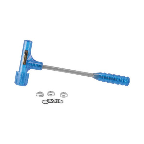

    Also, what hammer do I need?

                    When you need to pull some bullets for whatever reason, and impact style tool is the easiest method. Just one stern "whack" and the bullet is separated from the brass. It is that easy. Three different collets are included allowing you to pull bullets from just about every caliber rimmed or rimless. Versatility makes this bullet puller the only one to have.
