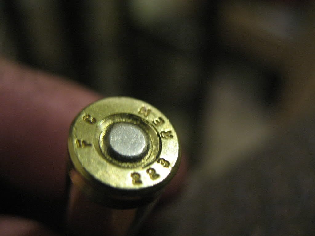

    Cheap Crimp Removal
    I sought out to find a way to remove military crimps without having to buy any more loading equipment and wanted some input on what I did. I used a countersink bit chucked to a drill and removed just enough brass to remove crimps. Primers all went in snug but there is a chamfered surface around the primer. Do you guys think this is cause for concern? I don't usually process crimped brass and know that a Dillon Super Swage would be best, but I still wanted to see if I could find a cheap alternative. Here's a pic. Thanks in advance.

    Done it, works fine. Just don't go too deep with the countersink, or the primer may not be snug enough in the pocket. I got worried that the primer might become loose under the pressure of firing and fall out, so I bought a Dillon swager. But the 300 rounds I did like yours in the picture never gave me any problems.

      the primers come out looking funn,they fill in the chamfer upon fire'n. I used to do it I don't anymore .. you can get 1k processed, sized, trimmed and ready to fill for 165.00 so i dont bother any more.

                Looks like its a little overdone, but not bad. Chuck a chamfer tool in the drill and hit the primer pocket for a second or two. Thats all you need. And its very fast.

                      Cutting the chamfer out like you have done works great for me. I have done countless thousands of .223 and .308 military brass and never a problem, I also find that it aids is primer seating in progressive presses. I chuck the chamfer tool up in a drill motor and then mount the drill motor in a vice so that my hands are free to lean on the spinning bit. The RCBS case prep center has a tool that does the same thing except it is painfully slow. The other benefit I find helpful is that when you have chamfered the brass you can visually see that it has been done, when you swage the pockets there is no visual indicator that it has been done and when you get mixed up brass it is nice to be able to cull your chamfered stuff right out and know that it has been done.
