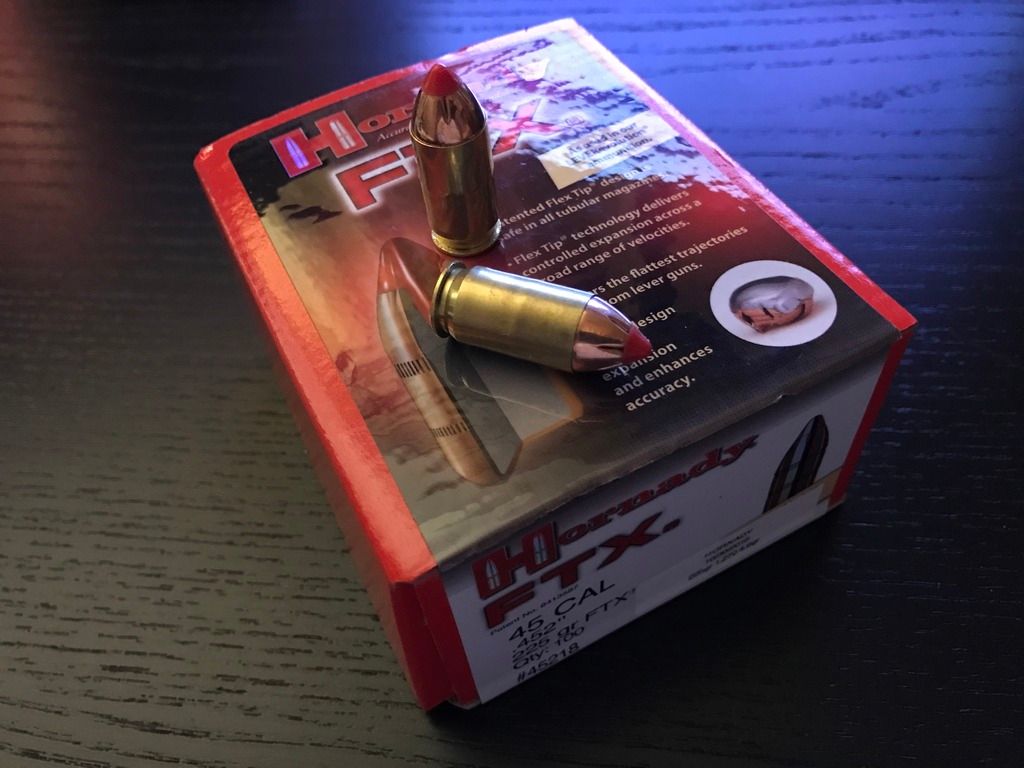

    Hey Fellow Loaders,
    I bought some Hornady FTX 225gr / .452 bullets before realizing for loading .45acp. I wanted to get some of your thoughts on this bullet for .45acp. I loaded them with 4.9gr HP38 seated at 1.270 and case gauge fine. Some quick searches indicate some have tied this before...
    RR.44

    I believe that you have .45 Colt bullets, .45-70 bullets, I'm not totally sure that those will be safe in a .45 auto.
    .45 auto is .451, I wouldn't shoot those out of a quality 1911 for fear of excessive pressure. I'm sure someone else will say it's ok, I however, wouldn't do it.
    Just my .02

            Not only do you possibly have the wrong bullet, but I believe you're supposed to trim the case when you load FTX bullets as well.
            If you're loading from the Hornady manuals, they have the product number for the bullet under the load data as well. Just a heads up for next time.

              I think you're right about them being 45 Colt not realizing at the time of purchase when I also grabbed FTX in .357.
              Thanks!
