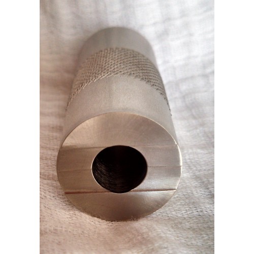

          Before ordering, would something like this be as effective to check the ammo?
          It's roughly the same price as the headspace gauge above so just wanted to check.
          Thanks for all the help and patience!
            http://www.cabelas.com/product/LYMAN...ge%26CQ_st%3Db
            Lyman
            Lyman Chamber Checker
            Quickly confirms whether ammunition will fit in your gun's chamber
            Machined from aircraft-grade aluminum for extreme durability
            Cut to SAAMI minimum chamber dimensions
            Easy-to-read engravings display cartridge
            You already KNOW that the questionable ammo fits your chamber.
            What remains to be resolved is why it self destructs once fired?
            A rifle chamber is a piece of steel with a hole in it. A cartridge gage is a piece of steel with a hole in it.
            NOT ALL HOLES ARE CREATED EQUAL.
