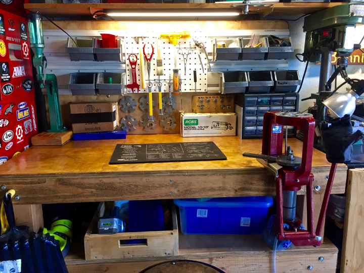

                      Meanwhile, here's mine: 48" x 24". 4x4 legs, 2x4 cross pieces, 1 sheet of 3/4 a/c interior ply for the top, shelves and back. Lag screws to hold the 2x to the 4x, wood screws for the plywood. About $100 for the basic materials. LED light overhead. Rock solid, this thing does not move or vibrate.

                        Originally posted by wbunning
                        Go wade through the thread in this forum on bench photos for ideas before you build! Tons of good ideas and hacks there.
                        Looking good !
