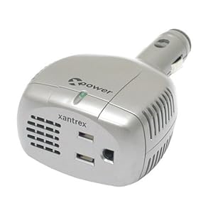

                Bought a Xantrex 175-watt inverter -- like this one --
                about 10 years ago for @ $25. Hard to believe it's going for 90 bucks used on Amazon now.
