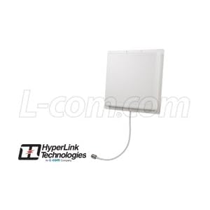

            That antenna will not work on the WRT series routers since they use a RP-TNC connector as opposed to an SMA. I'm also not sure that those high-gain antenna's will reach out 100' reliably or with a decent connection speed. Directional antenna's are the way to go for links over any distance. You don't even need to buy them if you have some pringles cans lying around. Just make sure you get the right connector for your routers and that your routers can use an external antenna. The router I mentioned above is a very good choice.
            Design with Intent. Engineered with Excellence.
            ETA: You will need two of these to plug that antenna into a Linksys WRT series router. I would also get longer cables so you can mount these outside.
