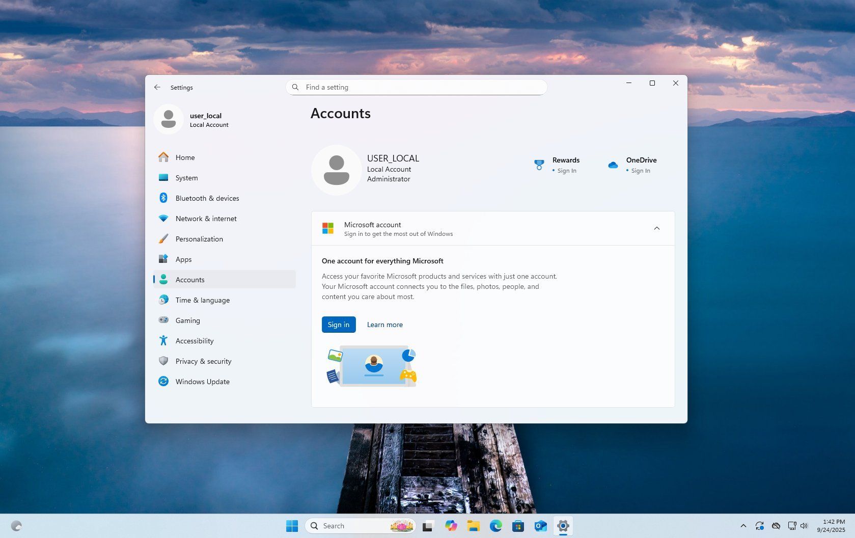

                If you don't like having a Microsoft account on Windows 11, here's how to get around the problem.
                Tip: During install if you choose English World for your region, it debloats the install. This is because it installs most of bloat based on your region and English World is not a specific region.
