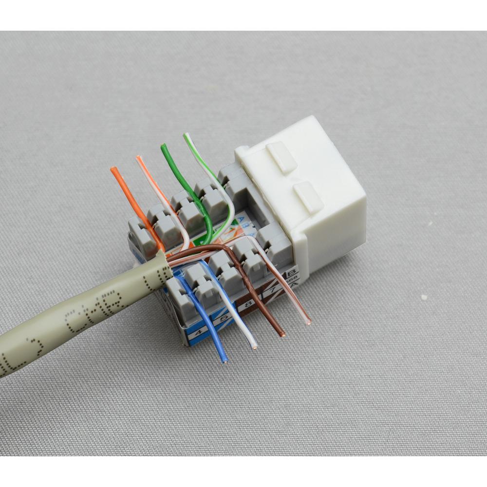

                          No no no regarding the cabling.
                          CAT5/6 that comes on spool is generally solid copper. The ends that you crimp on have teeth that can sever the solid copper strand or otherwise fail over time due to oxidation or movement.
                          Always terminate your solid copper inside wiring to jacks or patch panel, and use a patch cable to connect to the device. This makes it so the IW isn't stressed/flexed/fatigued over time. Even if this concern is nowhere on your radar, crimping ends on cable is a waste of time. Jacks terminate quickly and allows you to buy off the shelf, high quality, premade patch cables probably for less than you can make them yourself.

                              I'm not talking about oxidation along the bulk length of the cable. Yes, there is direct burial and suspension cable. Direct burial/exposed cable is usually black only (UV resistant pigmentation), and has dielectric grease between the outer sheath and the insulation for the individual conductors.
                              I'm talking about the terminations. There are different styles of ends, the ones you're 'supposed' to use for solid copper cable have teeth that are supposed to shear the strand insulation,and straddle the conductor. This is rarely a good gas seal and the teeth frequently don't straddle the conductor and instead cleave (and there's little way to inspect individual conductor to find out what it did post crimp). This is electrically a mechanical junction (the teeth conducting the wire conductor), the junction can weaken chemically over time due oxidation of the conductors at the junction, and physically by movement of the cable (simple flexing the cable, or reconnecting the device, accidents that tug, etc.).
                              Yes, plenty of people have done direct crimp ends and they may be serviceable for any effective service life. However, it's something that's completely unacceptable in any professional/commercial installation.
                              Crimping ends directly on the cable is NOT the only option, not only that, it is not the best option. It's also unnecessarily tedius separating the pairs, ordering them, inserting them into the end crimping. A jack a MUCH faster way to terminate a solid copper, is infinitely more serviceable, adaptable to future changes.
                              You would never use a PATCH cable for an entire inside run. That's not what a patch cable is. A patch cable connects your terminated IW/solid copper wire to the device (or device-device). Cable for IW is SOLID copper, if you flex it back and forth, or bend it too sharply, you can break the conductors. Take a patch cable and length of solid copper bulk cable and flex it, you can IMMEDIATELY tell the difference.
                              PATCH cables are stranded cable, which makes them more expensive, but are meant to flex and be service, it also allows you to adjust the length by simply replacing the section to the IW termination. The IW should never move once installed, yes you should route in a way that guarantees this. You cannot guarantee this if IW is connected directly to a device. Even the mass of the cable itself can be enough to pull a direct terminated connection over time.
                              You would use a premade patch cable for the length between the jack and the device, because it's cheaper, easier, faster, and better quality than what you can make.
                              There are surface mount boxes that the jacks can go inside, if it wont' be a wall plate or keystone patch panel.
