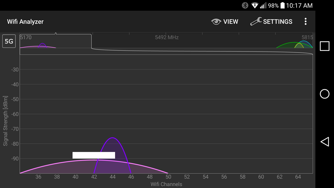

          You got me wanting to try gratis Android variants, and WiFi Analyzer shows a pretty good graph, and is helpful, providing you know how to drop into your router and change the channel for 2.4Ghz, and/or 5GHz, so you know which channels to monitor in the graph.

          EDIT: Since this post started being typed, I changed the control channel of both my 2.4Ghz and 5Ghz radios, as neighbors and their equipment change from time to time, and I haven't checked the spectrum in many months, so it was time to re-check anyways.
